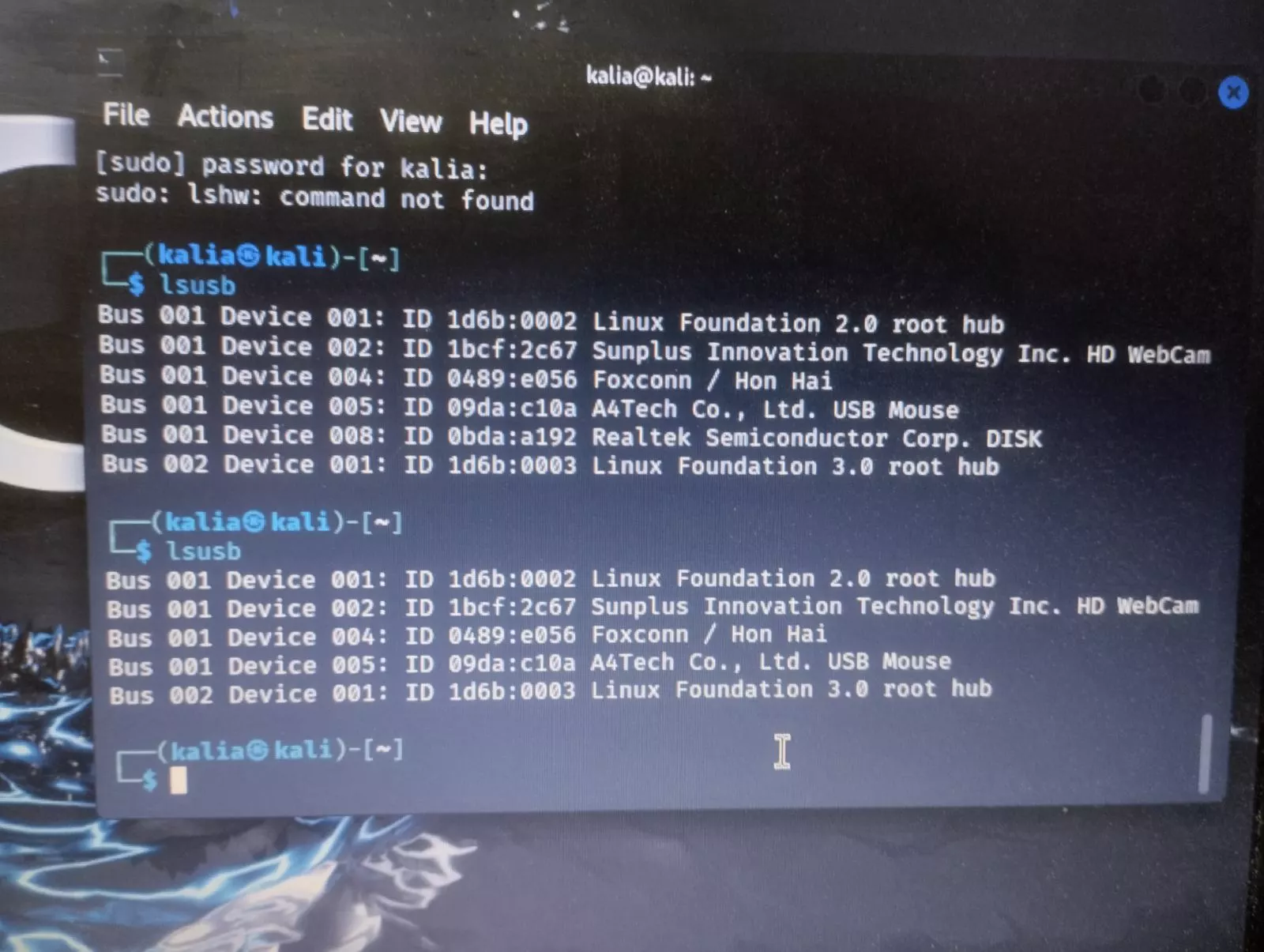

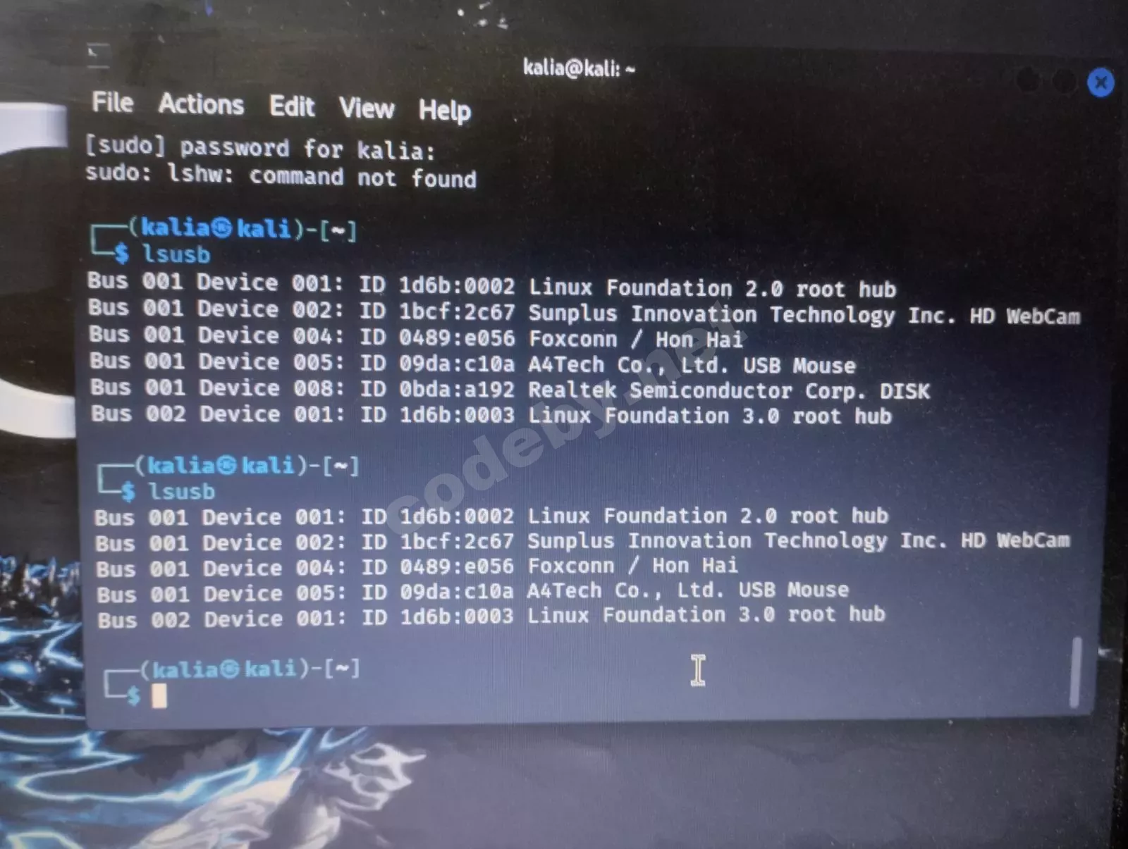

Если утилиты lshw её можно установить из репозитория
sudo apt install lshw
Так я по цьому для початку і пробував, в мене невідома команда lshw, а зараз ваша силка не грузится, і в мене не віртуалка
Среди этих устройств wifi адаптера нет.
Что это за адаптер? как выглядит? что на нём написано?

[17028.203707] usb 1-5: USB disconnect, device number 9
[17436.673396] usb 1-5: new high-speed USB device number 10 using xhci_hcd
[17436.821639] usb 1-5: New USB device found, idVendor=0bda, idProduct=a192evice= 2.00
[17436.821656] usb 1-5: New USB device strings: Mfr=1, Product=2, SerialNum
[17436.821662] usb 1-5: Product: DISK
[17436.821666] usb 1-5: Manufacturer: Realtek
[17436.823335] usb-storage 1-5:1.0: USB Mass Storage device detected
[17436.823645] scsi host2: usb-storage 1-5:1.0
[17437.839290] scsi 2:0:0:0: CD-ROM Realtek USB Disk autorun 1. 0 ANSI: 0 CCS
[18038.697616] usb 1-5: USB disconnect, device number 10
[18076.843981] usb 1-5: new high-speed USB device number 11 using xhci_hcd
[18076.992322] usb 1-5: New USB device found, idVendor=0bda, idProduct=a192evice= 2.00
[18076.992338] usb 1-5: New USB device strings: Mfr=1, Product=2, SerialNum
[18076.992344] usb 1-5: Product: DISK
[18076.992348] usb 1-5: Manufacturer: Realtek
[18076.996671] usb-storage 1-5:1.0: USB Mass Storage device detected
[18076.998721] scsi host2: usb-storage 1-5:1.0
[18078.017951] scsi 2:0:0:0: CD-ROM Realtek USB Disk autorun 1. 0 ANSI: 0 CCS
[18108.024030] usb 1-5: USB disconnect, device number 11
[18112.267334] usb 1-5: new high-speed USB device number 12 using xhci_hcd
[18112.415683] usb 1-5: New USB device found, idVendor=0bda, idProduct=a192evice= 2.00
[18112.415693] usb 1-5: New USB device strings: Mfr=1, Product=2, SerialNum
[18112.415696] usb 1-5: Product: DISK
[18112.415699] usb 1-5: Manufacturer: Realtek
[18112.416742] usb-storage 1-5:1.0: USB Mass Storage device detected
[18112.416923] scsi host2: usb-storage 1-5:1.0
[18113.441120] scsi 2:0:0:0: CD-ROM Realtek USB Disk autorun 1. 0 ANSI: 0 CCS
[ 2.342036] ACPI: bus type USB registered
[ 2.342089] usbcore: registered new interface driver usbfs
[ 2.342105] usbcore: registered new interface driver hub
[ 2.342122] usbcore: registered new device driver usb
[ 2.387135] xhci_hcd 0000:00:14.0: new USB bus registered, assigned bus number 1
[ 2.392625] xhci_hcd 0000:00:14.0: new USB bus registered, assigned bus number 2
[ 2.392631] xhci_hcd 0000:00:14.0: Host supports USB 3.0 SuperSpeed
[ 2.392749] usb usb1: New USB device found, idVendor=1d6b, idProduct=0002, bcdDevice= 6.08
[ 2.392755] usb usb1: New USB device strings: Mfr=3, Product=2, SerialNumber=1
[ 2.392758] usb usb1: Product: xHCI Host Controller
[ 2.392760] usb usb1: Manufacturer: Linux 6.8.11-amd64 xhci-hcd
[ 2.392763] usb usb1: SerialNumber: 0000:00:14.0
[ 2.392984] hub 1-0:1.0: USB hub found
[ 2.395162] usb usb2: New USB device found, idVendor=1d6b, idProduct=0003, bcdDevice= 6.08
[ 2.395170] usb usb2: New USB device strings: Mfr=3, Product=2, SerialNumber=1
[ 2.395174] usb usb2: Product: xHCI Host Controller
[ 2.395176] usb usb2: Manufacturer: Linux 6.8.11-amd64 xhci-hcd
[ 2.395178] usb usb2:
З під віндовса, вияснилось шо мій свисток - realtek rtl8192fu
Знайшов статью - GitHub - kelebek333/rtl8192fu-dkms: RTL8192FU driver for Linux
Зараз вперся в помилку((
0-02-05-61b837ef39264346582ea105e833f41ffe0797fbb3d4d6f9c5d07b3797c80b5c_187f44aed90db00b.webp
